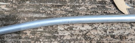

So with both valve caps basically the engine is destroyed. So absolutely time for the shop and not mine

Omg I found this. I'm not saying another wordView attachment 69202
Was that push rod in the engine?
(if so maybe it's making parts like push rods and valve caps by itself when it running and might start making bigger parts and throwing them out of the block before long) Briggs engines have been know to make their own parts sometimes.
Would also be a hint as to some of the strange noises you are hearings.
Keep a eye open you might see a check engine light come on later.

Forest, here's where that 19.5 Briggs& Stratton OHV engine stands so I put a brand new push rod. I happen to have an aluminum one and that's exactly what I needed and it was brand new so that's in place. The valve caps are in place. The intake is at 4000. The exhaust is at 7,000 brand new spark plug. So to make a long story short, it starts up instantly which is what I was doing before. But now the new twist is after a couple seconds. It just shuts down and I don't know why. I have been using carburetor cleaner. You know I can't explain it but I'm just telling you what's going on could make a movie of it so it starts up perfectly. Whereas like a few days ago the flywheel would not even rotate.
So the question is and it's not really direct towards you but if it keeps rotating the flywheel is it going to be okay or is it going to break again that I don't know.
