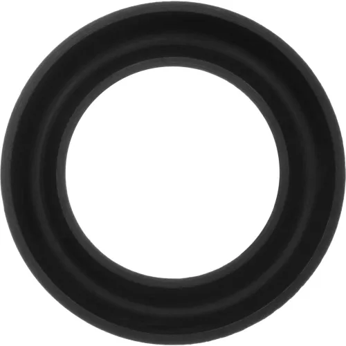

Civic, you said, "if you look hard enough you can find a 1/2 by 3/4 seals."
I tried a couple times, and gave up. Any suggestions of where to look "harder?"
civic
Oct 31, 2016
109
  • / Can't Pull Mower Backwards - HRR216VLA to bearing conversion
This where I saw them. The seals I used I found laying around my junk draws.Sorry for the long delay. I need to check back here more often.
McMaster Carr is the go to for things like seals, O rings , Quad rings & the like .
Down side is you have to buy them in packs. some of which are quite large
