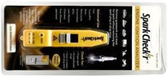

Any of the testers that don't jump an actual gap will give false positives. The grounded spark plug can be more reliable than blink testers but can cause issues sometimes were they will spark outside the engine but not spark under compression.
I tend to use these for cases were I am working on an engine that maybe loosing spark due to high related damage to the coils
1719708140241.pngor for quick check were spark maybe questionable 1719708714466.png
But both will give false positives.
But use the Briggs tester or HEI for serious testing.
