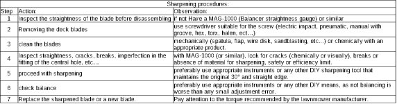

Well, I summarized what was said so far in a procedure chart that will be my bible for sharpening... I also included some examples...
