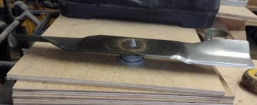

I sharpen mine on a bench grinder and spray them with water from a squeeze bottle to keep them from over heating. I used to balance them on a nail but lately I’ve used one of those aluminum cones. Works for me.
Exactly what I do, works perfectly. Toro Timemaster blades last an entire season, 20 hours/week usage. Sharpen them every month or so…
I sharpen with a bench grinder. Some might call it an antique, but I use it all the time. If the sharp edge is getting too hot you are moving the blade too slowly when making the last couple passes. I balance on a cone I picked up 30 or 40 years ago.
