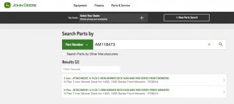

William it is JD PN AM118473.
We must be on different planets because the part No you listed brings this up from the JD spares page which does not appear to be a pulley.
And the results for F033J420911M were not all that enlightening either.  F033J420911M.jpg
So obviously you know something about it that I don't but I am always willing to learn.

Bert you just got to know how to read the serial number posted. As the tiller is a model 33 Tractor-Mounted Tiller.
And yes I am on a different planet. It just in the sweet spot of Earth orbit where you cant see it. Here is a map of Torland.
Here is the JD model search results.
The reason you not finding the part as expected it is a supersede PN of the original PN AM31705 that was superseded to AM34985 and then superseded again to AM118473 which requires bushing PN N189096. It also can be replaced with JD PN AN152951 but overall OD is just 3.25" and with 2.75" flat diameter.
