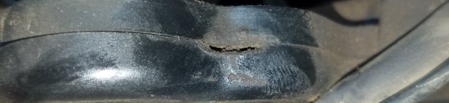

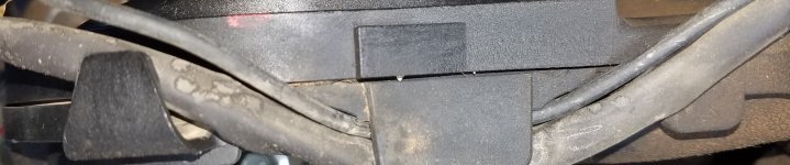

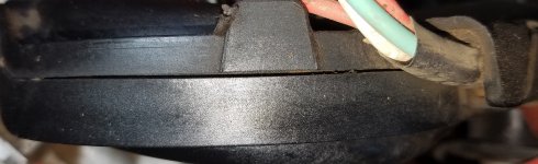

It is plastic. How can I test your theory?
I've attached some images of the manifold. the seem and top dead center...take a close look.

Carb spray. When it starts acting up, carefully spray the seam and the ends at the head.
ok, done. ran it, and when it started to die, I sprayed the seams...no effect. I then sprayed some carb cleaner directly into the air box, and the engine picked right up and rev'd, for a moment anyway. Should I take apart the carb again and take a closer look?
