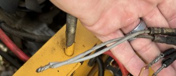

by and large the only thing that the switch itself will cause the fuse to blow is if it connects the B (battery ) terminal directly to the G (ground) terminal.
After that it has to be a wire that is connected wrong.
So the next trick is to unplug everything one at a time till the fuse stops blowing starting with that alternator stator plug which I rather think is your problem as both the AC & DC
wires appear to be connected to some thing and you can not do that .
It could even be a bad relay
