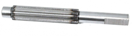

If there is a bearing in there it’s probably a ball bearing cheap press fit into the housing. If you provide us with the units model and serial numbers we would have a better idea.
12,631
More likely a needle bearing or bushing but without the equipment numbers it is only a guess.
sgkent
Sep 27, 2017
35
1,964
best guess is you will be the guinea pig in this experiment. Most of those type tillers the last 25 - 30 years or so that I have seen have welded case halves, that are disposable, and not easily disassembled. A Tractor Forum might have some folks who have dealt with bolted together transmissions like yours. I think if someone here was commonly versed in that transmission they would already be posting answers. My GUESS is that the shaft simply slides thru the inner race and will be a ball bearing based on the design and seal type.

Thanks folks. I’m going to try a hybrid plan… first a good cleaning then I’ll soak the drive end in a bucket of diesel. Then I’ll try the vice method with a heavy dose of liquid wrench applied under the sprocket. I’ll update in a week.
If you soak in diesel remember to degrease before you apply the penetrant of choice because most will not work on oily or greasy surfaces .
