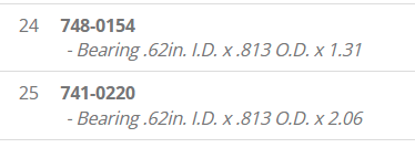

There is two different sections for this till with input. Going the image post you are working on the Chain Case Assembly 04924
748-0154
741-0220
No image found that looks right. May be NLA. May have to use two 748-0154 and cut to the correct length.
The input shaft here uses two bushings. And yes when bushing are use the shaft and bushings can seize from rust. I currently working on a Gravely ZTR that all three idlers arms are seized from rust even the part of the system uses plastic bushings. It took a hydraulic press to get them apart. One so seized that both the plastic and steel bushing came out as one piece.
