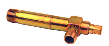

Another option was
or
Probably still would need to loosen the engine to install either one but they are better than the plastic one.
