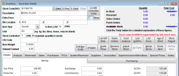

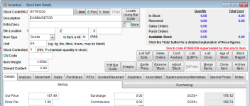

Kinda wish the solenoid was only $50 as Briggs no longer has the solenoid available and their solution is replace the whole carburetor assembly; although, there is a fuel bowl kit available although not noted in the IPL.
Fuel bowl kit came with the solenoid the last time I brought them.
