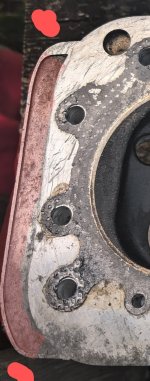

It's July 8th about 6:00 a.m. I took off the cylinder head that is matched up with a 19.5 OHV engine. The one I'm trying to work on and I took the cylinder head from a 14.5 OHV Briggs& Stratton engine. The holes the seven bolts line up perfectly. The only thing I noticed is the cylinder head for the 19.5 horsepower Briggs& Stratton OHV engine is more beefy towards the exhaust side. It looks like it's just better built. The question is because I can't upload the image of the comparison is do I need that extra beefiness the short block which is part of the 19.5 horsepower OHV engine this I don't know. Also, I was able to use an RC 12yc spark plug and it went into the older cylinder head which is what I'm trying to fit into the 19.5 horsepower engine.

Okay so this image is the cylinder head I really want to use but the spark plug hole is destroyed. So what you see in a faint red color that beefiness does not exist on the 14.5 horsepower cylinder head which is what I need to use because the spark plug hole is perfect. So this is really the question. Do I need that extra beefiness?
