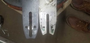

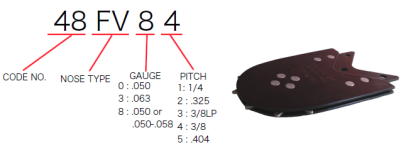

PT sit down and do you research...Otherwords you got some self training to do to educate yourself on bars and chains. It not something you can do overnight either it will take time absorb the info. But you probably have a few cobwebs of the mind to clear out to make room for the info too.There is times here that I got to fight my own cobwebs to retrieve things I got stored away from 20+ yrs ago.
The Oregon catalog is a good source of info; although it is limited too as you must combine your resources. I had to learn about these on the fly myself as I repaired chainsaws but now it is easy to get the right setup quickly. Of the three catalogs I got here Oregon, Rotary, and Stens; the Oregon catalog is the best when it comes to chainsaw bars and chains.
