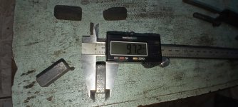

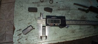

Yes, I kept it carefully ...
So, by this measure, the high part of the disc faces the tip of the shaft ... in mine there is a difference of approximately 3mm, coinciding with your information.
New tablet
used tablet

Replace them.
There should have been shims behind both
If so the thicker on goes behind the moving pad .
You adjust the brake by the middle nut which moved the lever in or out.
Done on the mower so the brake comes on just as the drive belts gets loose enough to slip.
Note, this is a sudden death brake it is either on or off as it locks the layshaft which locks the diff so the wheels can only turn is opposite directions

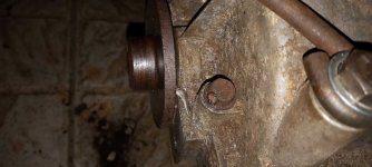

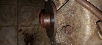

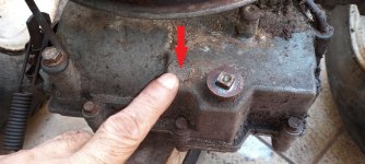

As for the oil change, I sent an email to Peerless about the possibility of drilling (without opening) the same point that appears in their own manual ... they still haven't answered me and I don't even know if they will ...
What do you think? My problem would be limited to just buying or making the plug (Nylon or rubber?)

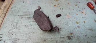

I understand. This might help you out. I’ve seen guys who cannot get pads go to the big semi repair shops and get a piece of brake pad. They would them cut their own pads and in a pinch this seems to work.

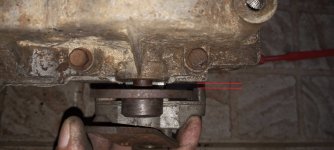

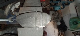

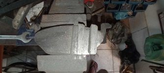

With a few hours of searching and working, I managed to make the tablets exactly ... but ...
Either the inserts do not have the same thickness (internal / external) or there is some difference in my system, because the external support does not touch the transmission box, there is still approximately 4mm missing.
But now I know how to specify the maximum size, because with the pads in place and the brake fully retracted, the support has to touch the gearbox housing ... just adjust it ...
The way was this and in the morning I will have brand new home-made pads at zero cost ...
I don't know if hardness will make any difference when braking, but then just take another one and redo it, as the technology is already assimilated.
Used car pad

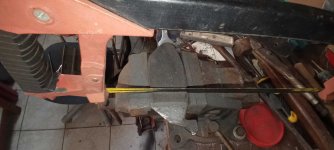

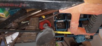

After grinding and sanding ...
The diference...
