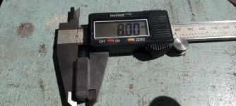

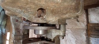

2 - After sanding, experimenting, sanding, experimenting ... I reached a maximum thickness value, to fix the support with the pads in place, without braking. The thickness was 8mm (0.315 ") ... it shows! This on my system, which has some differences in relation to the manufacturer's manual, which may be some adaptation or solution on the part of the importer.

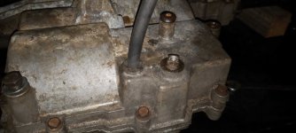

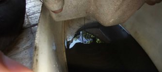

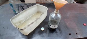

3 - I removed the screw, spring and ball assembly and turned the box upside down and ... oil came out !!! As the passage is very narrow and the oil thick, it is coming out very slowly, but I believe it will be possible to measure the quantity and replace this old and very dark oil. But the ideal would be the proper place for the oil to come out in good volume, bringing eventual dirt, filings, etc ...
Now, even if Peerless doesn’t answer me (which I think is quite right), I can drill in the appropriate place, but I need you to tell me what material the cover is made of, as it is certain that it will be an absurd value and I can do it one...

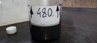

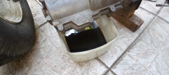

Although I managed to drain the oil through the hole in the ball, drilling the box could be an option, but the amount of oil that came out, after 2 days with various inclinations, was half of what it should be (like in a car, standing up) 5% must be normal), indicating that:
1 - or leaked (although with no apparent traces)
2 - or was it poorly maintained (?)
3 - or has already been assembled at the factory with a small quantity (difficult, but possible)
Now I'm going to drill and wash the interior with kerosene (dissolving and loosening the thick parts and filings), and put the right amount of oil.

Well, as I said before, I drilled the hole and put 1 liter of kerosene ... I swung in several positions until I was tired ... something like sand (!?!) came out, small pieces of joint and very fine iron filings of used gearboxes.
Even when swinging and rotating the axles with kerosene, no part leaked, ensuring a good seal.

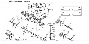

I put the amount of 500ml of SAE 90 oil (here we don't need the 80W90), and now I wait since last Thursday, Murray representative's quote for flat washers (29) and lock washer (29C), which I found worn on the input shaft. .. the ring hangs (27) I bought in a parallel store.
With these worn out components, the gear goes wrong in the differential and starts a characteristic noise ... without these parts I cannot finish the gearbox.:cry:
