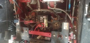

This is what an older is3100 with separate hydros looks like. The belt is on the bottom under a frame. There are no pull bypass levers on the hydros.

This mower does not have levers to release the hydros. It has a valve on each pump you have to loosen with a 5/8 wrench.
Yes valves are located right side of rubber hose shown in picture
