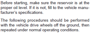

122
12,902
According to the IPL I looked up it has a pair of Hydro Gear PJ-3GCC-GCC-GZ1F-XXXX pumps so PJ service manual is needed.
