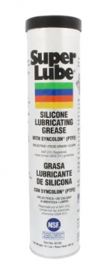

Best grease is silicone based. Silicone is anti-water slash moisture. Does not react with rubber parts/bushings like petroleum greases do.
