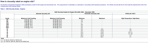

Viscosity cst is rated at 100C or 212F. Hydrogear is confusing the situation by using some non-standard recommendation.
The original post said 110C and a 9.0 cst. Still an SAE20 to SAE30 oil.
So from what you said Hydrogear is saying, a 9.0 cst at 120C is perfect for an SAE30 oil.
An 80w-90 gear oil is roughly the same viscosity as SAE30 engine oil.
Engine oil cst ratings
GEAR or transmission oils
Notice they list cst at 100C.
