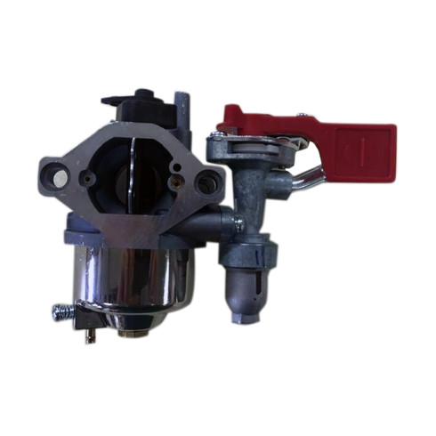

@mechanic mark So Mark can't do a repair kit because the non removable brass emulsion tube is broken in my carb.

Your right it is my fault that Briggs filed for Bankruptcy, It is my fault that Briggs is averaging 6-14 months for backordered parts. it is my fault that I haven't installed the 1 aftermarket carb made for this engine that has a 50-50 chance that I will have to repair either before installing it or shortly thereafter and sells for the same price as the OEM carb. And I am not threatening the customer with a new engine. But if parts for this engine are is such short supply or maybe not even available as an OEM or aftermarket what do you do.. Since the customer disassembled the engine prior to bringing it to me and lost all air filter bolts and nuts, the air intake nuts, and bolts, the starter bolts etc, and some of those took 4 months to get because of backordered. So I guess it is also my fault that the customer dumped the bolt bucket off the back of his trailer while trying to deliver the vacuum to me.Your doing more harm than good the longer you keep this machine. Either give it back NO CHARGE or fix it with an aftermarket carb. Its not worth the aggravation and its not worth soiling your reputation over. Blaming everyone and everything else over the problems your having with it makes me question your abilities. Threatening the guy with a new engine sounds like your punishing the customer for your failures. Who gets the old engine I wonder?
Ordered it. At this point don't have any other options.. Just hate going aftermarket unknown parts sometimes because it cause repair issues down the road. Ran into a Nikki knockoff last summer that the OEM kit wouldn't repair. Had to replace the carb on that one also.Brand: spartshome
