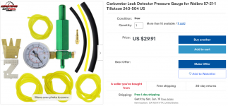

My uncle's Toro blower is defying all efforts. It will not turn over. It has a new plug and ignition module. I have tested the wires to the switch and the switch. I pulled the flywheel and checked the shear pin. The ignition module is grounding properly. I contacted my friend who has been in the repair business for years and he said " you covered all the bases that know ". I didn't do a full compression check. So I guess that could be an issue, but the compression does seem good. If anyone has an idea, please assist.
What brand is the ignition module?
How were the wires tested to the switch?
What about cleaning the OEM carb? Check for cracked fuel lines. Fresh fuel and 50:1 mix? Carb rebuild time?
What was the compression value?
You need to test the carb with one of these.
