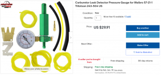

You need to test the carb with one of these.
