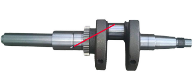

@BurntFingers, keep us posted on the drilling. IMO seems like an easy fix providing the longitudinal oil passage is there. If it isn’t, will still be easy but not a fix LOL.

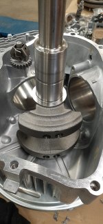

The topic is ROD BEARING OILING on a 49xxxx series, I don't know why people

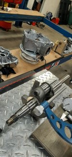

That crank is on the shelf for the time being but I'll definitely drill that oil passage..
the motors reassembled with a good crank and rods and already put into service.

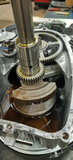

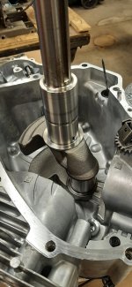

considering the two crank oil channels were not drilled, there is a non zero chance that if you did a DIY drill out or water jet the crank will not be balanced...no? I've never done the machining myself, but it would appear that removing that much material in two directions on the same "plane" would necessitate some kind of crank balancing work afterwards, no? just intuitively, that looks like at least about 2 ounces of metal that would be removed if you did the drill out. two ounces is probably going to cause problems with bearing at 3600 rpm..I would imagine. I dunno...not a machinist...but it would seem there is more to this job than just drilling it out.
also this: there does appear to be some crank wear likely due to lack of lubrication (not lube channels).that dull gray streak looks like a red flag to me...I'm not aware of how this crank is built or how one would relap even if that is possible...

Drillin a Crankshaft might be a little tougher than it looks
It will piss you off how Soft they are. I once installed a Roll Pin in place of a worn out keyway...Thru the Flywheel. Cheap Harbor Freight drill bit went through that Crank like Butter. For the Oil Passage, simply dremel a small area enough to drill the correct angle. With Oil in the passage it may be less Unbalanced and as Taryl says and we all know...It ain't the Space Sh....

IMHO, another point to consider is that the engine this crank came out of is back in service with a replacement crank.
Since there is no engine to put this crank into, what's the point of wasting any time or effort on it.
