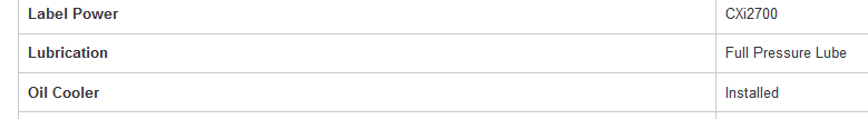

If one hole is missing then what about the passages from that hole to the rod bearings' holes?
I think one should be talking to Kawasaki about a new engine in exchange for deleting this thread.
  • / SOLVED: NOT INTERESTED IN WARRANTY ADVISE-27hp 49T877 V-twin rod bearing oil
If it is supposed to be crossdrilled and it is not them that is a maunfacturing defect and is warranty no matter how old the engine is.
The factory can not honour it because there is no way, you the customer could have done a Penn & Teller and made the oil holes vanish
I am assuming that you have put an air ile / oil can to the holes & verified that they are blind .
In this case take it back
However you need to check the specification of your engine
There is "pressure fed crank" and "full pressure lubrication" they are not the same thing

Hey guys,, Just to clarify, I bought this in an auction parts lot with other motors. It was already knocking way before I got it
I'm not the consumer.
I assume they already got a warranty exchange and I'm not looking for any compensation from anyone.
Well that is a totally different story
In that case , if the crank is otherwise in good shape, take it to a jobbing engineering workshop & get them to drill the cross drilling
Water jet drilling would be the preferred method considering it is a crankshaft and the hole is at an acute angle to the ground bush area .
Or just replace the crank with a new one
