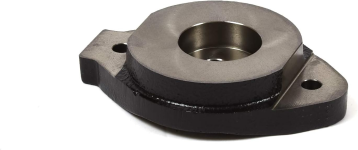

Just had a thought when I went back and reread your OP. You said that you overhauled your pumps. Did you remove the football shaped cover with the oil pump in it. If so it could be possible that they have been reinstalled 180 degrees from original which will prevent proper purging because they would be trying to pump the oil out of the system instead of pumping into the system.

I’m assuming you’re talking about this charge port?Yes I removed it. How would I tell if it needs to be rotated 180? I didn’t see any type of marking that would indicate a direction that it needed to face
Installation is directional

I am talking about this View attachment 68679
After looking at pictures taken before/during the disassembly and reinstallation I think that might be part of my problem. It’s bittersweet to see now as I’ve already given up and loaded the mower on a trailer to bring it to the shop on Monday and now my curiosity is peaked enough to pull it back off and see if that fixes it lol
