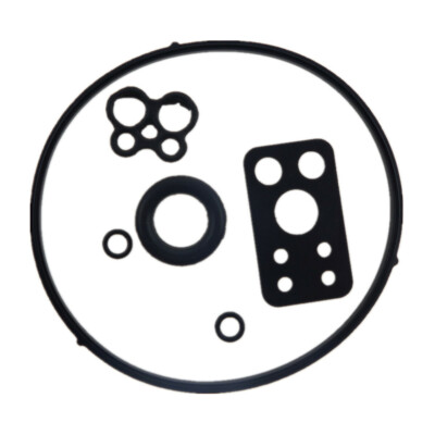

Yes but I can charge them out at $ 5.00 along with the B & S part number so convince the customer I am better value than the glass fronts .

So this o-ring is a part specifically manufactured for B&S?

I have used a dozen or so of these with no problems. Usually all i need to fix a nikki 2 barrel.
From memory they come from DC spares in HK and are around $ 1.20 a hit so he is buying them by the box load , probably down to less than $1 a piece and flogging them for $ 6 . a piece on evilpay & probably amozone as well .

Not exactly sure which evilbayer i got them from. I still have about a half a dozen of them. Cheaper than the forty some dollar Briggs rebuild kits.

Well, I checked the float bowl, and from what I can tell everything is there. I got the float bowl attached by putting the o-ring inside the emulsion tube. Went together much easier. However, I did find something missing. The OEM carb has a spring on the choke shaft between the lever and the carb body. The new one doesn't have a spring. And it's a very tight fit between the lever and the carb body. There is about 3/8" clearance on the original carb between the body and the choke lever. There's a foam rubber disc between the carb and the lever on the new carb, where the spring should be. Even without the foam disc, there isn't enough room to install a spring, at least not one similar to the one on the original carb. Any ideas?
Thanks
Choke spring is only necessary when you have a single control wire that does both the choke & the throttle .
If it has individual control wires then the spring is not required .
That is why when ordering parts those code numbers from the engine & mower are important
