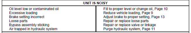

Now for the question: The Transaxle sounds a bit noisier than to the LT1000 that has already went to the scrap yard. It works great, but has a grinding sound that I thought would go away with use.
Any advice would help, Change oil?, etc. I don't want to run it until it fails when I can do something to save it.

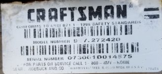

Post Model # from under seat, starts with 917. thanks, Mark
LTX1000
Dec 3, 2022
Here it is........ 917.272420

Is the noise when you just release the brake/clutch or is it only when moving.
If moving troubleshooting.
So it looks like you have a Hydro-Gear 314-0510 transmission
IF it suddenly got noisy then you have a pulley bearing or belt problem
If it was always loud & just got louder then chances are the transmission is past it's use by date
Your mower dates from 2001 to 2005 so even if it is a late model, it is near 20 years old
The 314 was not a particularly robust unit and is good for 1000 to 1500 hours
So if the brake is not dragging then the trans is sending a message of good-bye
The cheap & nasty test is to park on a hill turn the engine off and give the mower a push down the hill.
If it resists being pushed and stops the instant you stop pushing then the tranny is good
If it takes off like a frightened bunny rabbit then the unit is shot
If it slowly continues to roll down the hill then an oil ( and filter ) change to a heavier grade of oil may add a few more seasons
10,271
Manufactured July 30, 2001
