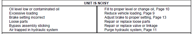

Now for the question: The Transaxle sounds a bit noisier than to the LT1000 that has already went to the scrap yard. It works great, but has a grinding sound that I thought would go away with use.
Any advice would help, Change oil?, etc. I don't want to run it until it fails when I can do something to save it.

Is the noise when you just release the brake/clutch or is it only when moving.
If moving troubleshooting.
So it looks like you have a Hydro-Gear 314-0510 transmission
IF it suddenly got noisy then you have a pulley bearing or belt problem
If it was always loud & just got louder then chances are the transmission is past it's use by date
Your mower dates from 2001 to 2005 so even if it is a late model, it is near 20 years old
The 314 was not a particularly robust unit and is good for 1000 to 1500 hours
So if the brake is not dragging then the trans is sending a message of good-bye
The cheap & nasty test is to park on a hill turn the engine off and give the mower a push down the hill.
If it resists being pushed and stops the instant you stop pushing then the tranny is good
If it takes off like a frightened bunny rabbit then the unit is shot
If it slowly continues to roll down the hill then an oil ( and filter ) change to a heavier grade of oil may add a few more seasons

I don't know the history of the mower, e.g. hours. When I got the engine running, I put it in gear the first time with my fingers crossed not knowing what to expect being it was sitting up for two years out in the weather. It moved forward, noisy, but no slip or drag. I moved forward and back in low several times increasing the distance a little each time. I then went through all the gears driving around the yard. The noise stayed at the same level no matter what speed or in forward or reverse. I kept the RPMs Constance at 3600. I didn't think about the idler pulley, clutch or PTO because the noise seemed to be coming from the rear. I jacked in the rear end up and rotated the wheels listening for a bearing noise. No noise there. Before I drop the transmission, I think I will check the idler pulley.
Oh! what drives the cooling fan? Should it be free wheeling in either direction when the transmission is not engaged? It feels like the center of the fan hub may be stripped out.
