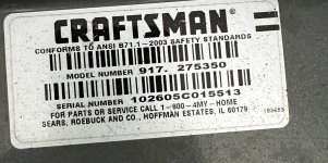

Hello I’m new to this! I have a craftsman lt1000 model: 917275350.
I bought it used and worked 3 mows before it chewed up the belt. It got stuck under the left side pully I believe it’s the one with the spindle. I went and replaced it and mowed again no problem. I disengaged the blades and then went to renegade them and it started smoking and got stuck under the same pully. I have to always check the belt before I engage the blades now to make sure it’s not stuck, it never gets stuck when blades engaged already. Does anyone know if maybe I’m missing like a spring or anything on my deck that would keep the belt on the pully? It also starts very slow an winds up slow when starting blades. I have tried to tighten the tensioner cable but it’s one of the mowers that doesn’t have the bracket to tighten it. I’m going to add the pic I have of the deck. Maybe you guys can let me know if any parts are missing as I bought it used. Thank you!

Well according to Manual ( the Mexican know it all ) that deck does not belong to that mower or if it does then the entire Belt clutching system is wrong at worst or upside down at best and probably a mix & match
According to one site, this is what the deck should look like
Part numbered 144 is the belt keeper # 193414 marked as NLA
Part numbered 148 is the return spring # 169022 also marked as NLA
I think you will find Husqvarna part # 532158634 is either the same or can be modified to fit
And same for 532173442 which is what usually goes on the tensioner idler
Stanley B & D have bought out Craftsman and as the new owners they are not obliged to keep parts for older models so they now come up as NLA
However it is a down graded rebadged Husqvarna so if you check the Date of manufacture ( which should be on the ID tag under the seat ) and search Husqvarna models for that year ( tractor data.com is good for that ) then you can find the sort of equivalent Husqvarna model and source Husqvarna parts .
Better still you can download the Husqvarna parts book for your equivalent model.
Some times if your mower was a year or two after a new Husqvarna model or major upgrade then the Craftsman is the superseded model
I have to do this sort of search all the time to work out what parts are needed for locally branded mowers where no parts lists are available .
