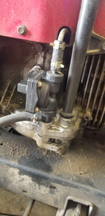

Does this fuel solenoid look retracted? It seems to. I don't know where the pin is. Should it be near the red wire?solenoid.jpg

The pin is inside the carb... you can't see it from the outside.

I don't remember that at all. Well, I guess there will be quite a bit more disassembly to do. There is this big plastic part over the carb. Disassembly looks rather complicated to say the least. I do not remember doing this last time. It's a shame my new lawn guy quit. My lawn would be mowed by now instead of being over a foot high. Getting close to two feet.carb_cover.jpg
I'm so tempted just to get out the sledgehammer and get that part of that way. It would be more fun, at least at first.

you should be able to remove it with the flats on it, either a deep socket or a wrench, most likely 1/2" or 13mm.. may be 12mm
