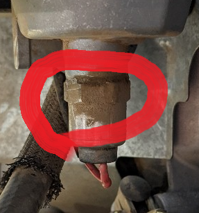

Does this fuel solenoid look retracted? It seems to. I don't know where the pin is. Should it be near the red wire?View attachment 60471
Pull the red wire apart. You should have 12 volts on that red wire with the key ON. You will have to remove (unscrew) the solenoid from the carb to see this plunger we are speaking of. It shuts the fuel off to the main jet when you turn the key off.

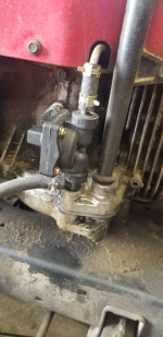

I don't remember that at all. Well, I guess there will be quite a bit more disassembly to do. There is this big plastic part over the carb. Disassembly looks rather complicated to say the least. I do not remember doing this last time. It's a shame my new lawn guy quit. My lawn would be mowed by now instead of being over a foot high. Getting close to two feet.View attachment 60480
I'm so tempted just to get out the sledgehammer and get that part of that way. It would be more fun, at least at first.

you should be able to remove it with the flats on it, either a deep socket or a wrench, most likely 1/2" or 13mm.. may be 12mm
It's totally stuck on there so that's a no-go.

I expect you have checked for/changed the fuel filter. Remove Float bowl and see if fuel runs out when cranking engine.
Remove Float and needle and use carb spray to spray back into the NEEDLE SEAT.
If you hold your finger on that solenoid you should feel it click when you slowly turn the key towards but not to Start.
Warm the fitting briefly with a propane torch and then cold water. Do that a couple times then with a tight fitting wrench try to tighten then loosen the fitting. You could also connect the two wires to a charged 12V battery and see if you feel/hear a click.
I've removed the carb solenoid. Just a small trickle of fuel comes out of the carb bowl bottom. Not gravity flow at all. This engine has a fuel pump. This pump seems dead. Filter looks good.
