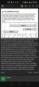

This chart for your particular engine is all you really need to know about oil choice. Note the "including synthetics".
