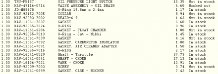

Sure they are will more for JD maintenance as I got a Z950R in the shop that parts alone are already at $200+ just for engine work and that using Kawasaki parts from my distributor and not ones from JD dealer.
At least it look like he would had needed a complete new carburetor for that FX850. JD is asking $556.70 [my cost] for the replacement carburetor. But it is only $396.82 from Kawasaki. Hopefully Home Depot have what I need for part of the repair. If not then I order the item from McMaster. I knew going into this project that choke shaft was complete worn in two which damage the carburetor main body and that there was a major oil leak.
Prices are each.
Of course this includes regular maintenance. The customer will be lucky if it get out under $600 after add the rest of the parts and labor.
