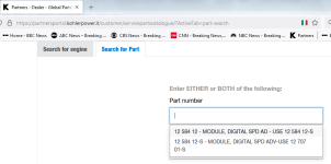

That isn't a voltage regular but is a Digital Speed Advance module for the ignition system. It currently superseded to the DSAI kit PN 12 707 01-S.
So if you installed a voltage regulator in its place it will not work.

The 12 584 12-S isn't a voltage regulator but is called a Speed Advance Module, sometimes a Spark Advance Module which says you have a CV16. This still doesn't explain why your replacement coils won't mount other than they aren't the correct replacement for a 12 584 04-S.
If your engine still has the original flywheel the correct Kohler part you need is 12 707 01-S. This is a DSAI conversion kit that eliminates the original no longer available Speed Advance Module and ignition module and replaces them with one ignition coil that has the advance built into it and it no longer needs any battery voltage which actually never went to the ignition coil but to the Speed Advance Module and in turn that module sent a lower voltage signal to the coil to trigger it. This kit will only need the white wire connected to it to kill the ignition.
