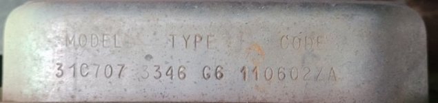

The engine part number is 31C707-3346-G2/G6. I'll get the engine model number the next time I'm by the mower.
Thanks

  • / Craftsman 247.288811 air cleaner cover removal - retainers just spin
Engine model number is 31C707.
Thanks
