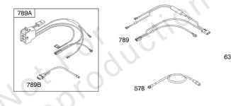

I picked up a used parts mower last week and the guy said it just needed a carb cleaning (ha) and it did fire when he shot it full of ether. When I started removing the carb I discovered the wiring connector to the carb solenoid was mangled and one of the wires is broken off. I downloaded the parts diagram and I can’t figure out what I need to replace. Which of these contains the carb connector?
Better yet, is there a way to just buy a new connector and splice it in? That’s bound to be cheaper. Or maybe just delete the solenoid and splice in a manual fuel shutoff? The engine is a 407677-0229E1. The manual specifies two different solenoids and this is the earlier one.
789 is the solenoid wire
The plug with the ground wire ( eye terminal ) on it is the solenoid plug
