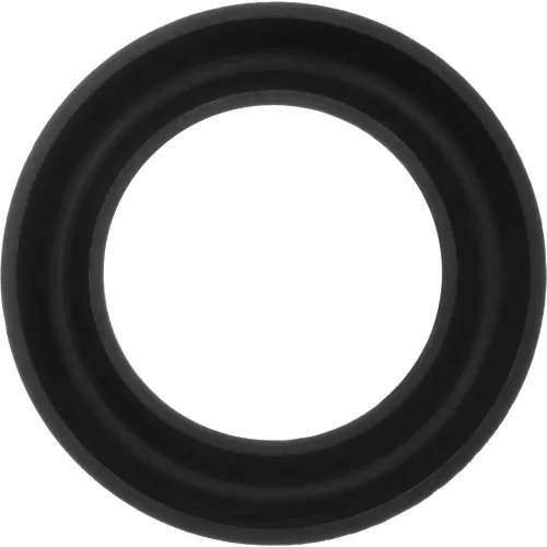

    (4) Honda 12.7mm dust seals

3) Epoxy the dust seals in place on both the inside and outside of the adjuster. I recommend using the transmission shaft to ensure alignment of the outside dust seal since that's the side we've drilled from and it will NOT self align.

I am not sure you can see it, but these needle bearings have an o ring or seal at each end

Sharing some info: I did a search on Amazon to see if I could find an O ring that would fit the wheel cover opening where Civic used felt (his "felt" mod). I found an O-ring, silicone based that looked like it might fill that space and help block debris from entering. I ordered from Amazon and received them today. Looks like a perfect fit. I installed them on the mower, no issue, so this looks like an upgrade to Civics "felt" mod but using a silicone O-ring. Here are pics, and a link to Amazon where I found them. Amazon sent me quantity = 25. Civic and Briantii, If you want a pair, drop me a PM and I'll send a pair of them to you for your use, no charge. I have more of them than I'll ever use, lol. Amazon link:
Nice! Thank you for the offer, I’ve got a whole assortment though so I’ve probably got one that will fit. I’ll give it a go next time I take mine apart. Thanks!
Great find Westman, looks like a better mod. Great find! I was looking today for an oil seal that is 1/2 x 11/16 and found none, however I did find 1/2 x 3/4 at work today but only 1 so far. It fits very tight but I think I can make it work. This is an obsolete part and will be looking to find another in the next few days.

#162
P
Pixburd
If you use the sealed bearing method you will need to drill out the adjuster to 3/4 in and if you look hard enough you can find a 1/2 by 3/4 seals. One other thing about the sealed bearings, now when I first start mowing my rear wheels will lock up only on the first pull back. These bearing looked light duty so I added 3 bearings to each side. Now I am wondering if I should not have done that. I bought a pack of ten and I could have put 5 on each side but decided on 3. Not a big issue unless it gets worse. I am still mowing about once every 2-3 weeks. My front yard has started to green.
Civic, you said, "if you look hard enough you can find a 1/2 by 3/4 seals."
I tried a couple times, and gave up. Any suggestions of where to look "harder?"
#163
C
civic
This where I saw them. The seals I used I found laying around my junk draws.Sorry for the long delay. I need to check back here more often.
#164
B
McMaster Carr is the go to for things like seals, O rings , Quad rings & the like .
Down side is you have to buy them in packs. some of which are quite large
#165
