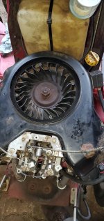

So you have a flywheel PTO
It is still not the timing key
The timing key is 1/2 in the crank shaft & 1/2 in the flywheel
The flywheel is the big round thing with the magneto magnets on the outside & the alternator magnets on the inside .

It can be the flywheel. Some engines the keyway is milled into the taper of the crank and all you see is the key in the flywheel and none in the crank

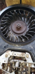

Take some wider pictures of the flywheel.

Only difference between these pics and the orginal one is I have the nut and metal spacer in place in these pictures. I know the flywheel isn't under the engine where the belts attach.
I'm probably just gonna send this thing down the road. It was free and I'm pretty much done messing with it. I have set littlerly everything I can to spec, replaced everything, swapped everything, and tested everything and nothing has made a difference. Short of splitting the engine and replacing stuff, it's all in spec and adjusted by the book.

So assuming that key is 100% intact, I would say rule out the key and abnormal timing. Again I'm no Tecumseh expert like others on here.
I haven't read every post but have you taken the flywheel off and held the flywheel key in your hand? Bad fuel or trash in the fuel could of course affect both sides but I would doubt both ignition modules went bad at the same time. If you're still working on it check the flywheel key and you have to take the flywheel off to do that. If that is good I would check valve timing next. I won't go into that now since I don't know if you've already junked it but if you're still working on it, checking valve timing is pretty simple to do and only requires removing one valve cover.
