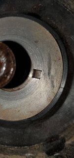

As far as I can tell the flywheel key looks good.

That's the engine flywheel and crank
Jul 14, 2019
81
5,911
Why is that outer black ring loose in a couple spots? Recon the key looks good.

This is the flywheel side on top of the engine
