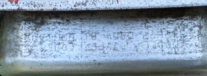

Did you ever get the engine model and date code? It should be stamped into the valve cover. If hard to read, get some "grime" on your finger and rub it across it. The grime will fill in the letters and give you contrast. Also can take a photo of it, if hard to read.
There are several parts (fan included) that require the date code to get the correct fan.

It's late at night, but it seems like you have a pretty exhaustive list of things to look at. And I absolutely will read it tomorrow morning. But I've included the engine code and it's just so hard to read and I'm pretty sure this is the best photo which is cropped that I have
Jim made

This is a good enough photo....
31P677-0804-B1 090130??
The last two digits are harder to make out but it looks like 7D or ZD... These will not likely matter much.

I have been using the above website link for the engine and this goes back like 3 years or more.
I also considered trying to use steel wool on the parts I couldn't read and then I was thinking maybe I just erase everything so I did not attempt that.
