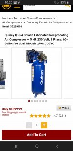

The compressor is a Quincy american made industrial 60 gal. Rated for 175psi. I installed an automatic drain so every time it starts it drains for ten seconds. The IR 2235 handles the pressure ok. I use 3/8 li e and high flow connectors. The air hammer is another story. Have to dial the pressure back or it is too violent to control

I switched from a 40 gal horiz compressor to the vertical quincy. Takes up half the space.
