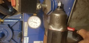

When i need to get seriousView attachment 60015
Most blade bolts come off pretty easy.
165 lbs of air....I tip my hat to you sir!
#16
165 psi is way beyond the design spec of my Air Cat as it is designed for 90 psi supply.
Hopeful the air tank is designed for this much pressure and the tank is drained every so often to keep it from rusting out.

The compressor is a Quincy american made industrial 60 gal. Rated for 175psi. I installed an automatic drain so every time it starts it drains for ten seconds. The IR 2235 handles the pressure ok. I use 3/8 li e and high flow connectors. The air hammer is another story. Have to dial the pressure back or it is too violent to control

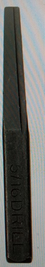

I am working on one spindle that someone put an under grade 5 bolt in. I had tighten it to the spec per Hustler. The bolt snapped off while the customer was mowing his yard. Hopely the 9/32 LH bit will spin the remains out but I also have a #5 extractor coming in today in the order.

Sounds like fun.
I have a bunch of Ez outs my father gave me. He got them from uncle sam when he was working for the CCC as a millwright during the depression. Haven't used the 1" one yet.
#24
I was going to a set from McMasters but the set is on a 6-8 week B/O so I just order the size I needed currently. Hopeful they are a lot better than those junk HFT ones as the first one I tried rounded off the spiral part.

Pretty well set for eztractors some are from the 1930's
I used to use those till I found these, they don't dig down & expand tightening against hole.20220409_125347 (3).jpg
