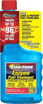

I am a big fan of Startron fuel stabilizer. Sold and used it for years. Always recommended it for winter storage with the heavier dosage and used standard dosage the rest of the year except on my big Z mower. Gas never stays in it very long. I have always stored with tanks full for the winter. 20 years plus as parts manager in the business.

I put StarTron fuel treatment in my gas cans before filling them with ethanol-free gas. StarTron was the only fuel stabilizer we used at the lawn equipment shop I used to work at. Service manager and lead mechanic said it was better than Sta-bil, so I used it in all my equipment during storage, and never had problems with starting my equipment afterwards. Gas with ethanol added is a repair shop’s best friend, as most of the no-start issues were due to the customer using gas with ethanol. When you recommend what gas to use, some will listen, but most will not.
