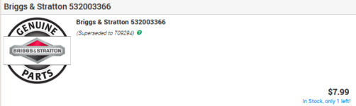

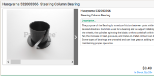

120
12,863
For those Briggs PN 709294 use Husqvarna PN 532003366 which are the same plastic bearings.
Or can use some the after market ones that are out there.
Now the website you post they would be
120
12,863
Also here is a couple other aftermarkets.
Rotary 8745 KING PIN BUSHING 3/4 X 53/64 AYP
Stens 225-700
