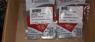

The washers arrived ahead of schedule ...
Although the lock washer is not a very hard steel, it should last a long time and I now have several.

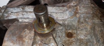

Due to the thicknesses it was not possible to place the 3 (1 lock and 2 spacing, according to the drawing), the lock must spend first and adjust, then I will put the second spacing ... maybe in 2 years ... the fact is that it was kept with a minimum spacing and without the noise of gears with incorrect fitting.

There should have been 2 spacer washers, but it was only 1.

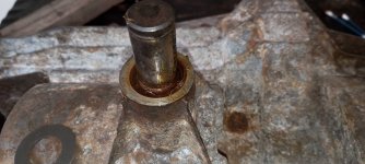

As it will have friction, a little grease goes well ...

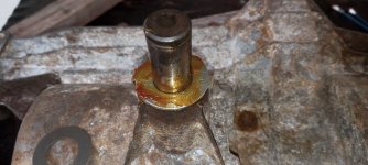

Now virtually zero clearance and no strange noise.
