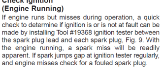

bentrim
Sep 7, 2024
100
Somewhere in the back of my mind I remember that for the ignition module to function both wires must be connected to a spark plug. yet the service manual does not specify.
Does your engine have points or is it magnatron
Note the trouble shooting paragraph and illustration below.
If someone can say I'm wrong -- please do so.
With spark plugs installed, attach a #19368 ignition
tester to each spark plug lead and ground the other end
of the tester as shown in Fig. 8. Spin the flywheel
rapidly with engine starter. If spark jumps the tester
gaps, you may assume the ignition system is functioning
satisfactorily.
