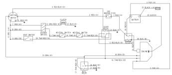

Where is the voltage regulator location I cannot find a good diagram or photo.

NICE ive been looking for one of these wiring diagrams. yes the 15A master fuse by the starter solenoid....starter relay? it looked good yesterday im going to check the continuity today. my meter battery was dud.

replaced fuse thank you for the input!!!! now we have noise but still not turning over. What charges the Battery this is a newish battery, Im taking it to get it checked tomorrow but im thinking the charging system is not working. Where do I place the multi meter to see if the alternator?? is working, if I get the mower running.

Since this fuse blew while operating check the PTO clutch coil resistance. Should be in the range of 2.65 - 2.92 ohms if it has the original Warner TG clutch. If below 2.65 then the clutch is partially shorted and needs replacing.
Now the only to test for charging is to have the engine running then you check across the battery terminals and the voltage should climbing above the battery's standing voltage and not above 14.8-15 volts.
