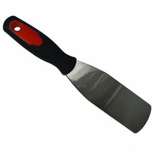

I made me a scraper to clean under the decks when I service mowers. It the scraper the carpet layers use to get the pad up. I just ground it where it is narrower so I can get in the front part of the deck where the lip is. Works pretty good but there are some where your really have to work to get the packed in grass off the deck.

I use a scraper called the grass buster. Works good except when the grass is packed 4" deep then i use a 2 ft prybar to pry out the big chunks first.
