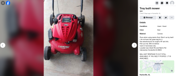

Example: this probably only needs bowl cleaned & bowl bolt wired out.
